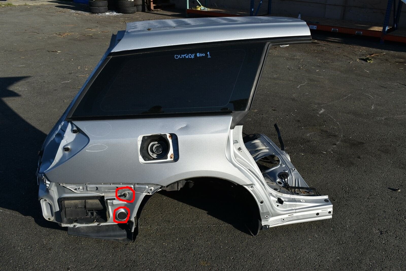

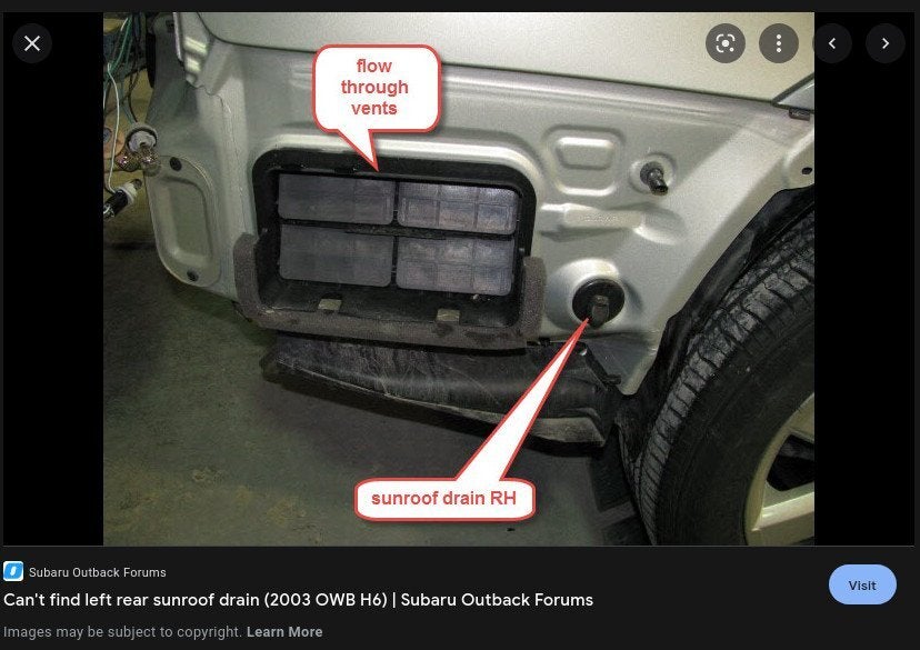

Moon roof drain locations and unclogging.
apexi replied to Chronuss's topic in Fourth Generation Legacy (2005 - 2009)
I looked into this a bit earlier, but was reluctant to reply without solid info. From what I saw, the sunroof drain should be one of the two locations I circled in red. The first silver pic is a 2005-2009 wagon, and the second pic is from a 2003 outback. It looks like the sunroof drains are very likely in the same location on both gens, and I don't think you should have to remove the rear bumper to get to them. Might be able to remove a few clips from the fender liner and reach around, or remove the plastic shield below and go up -

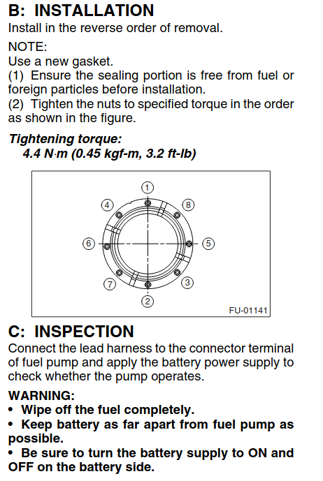

I remember when this happened to me, the dealer just replaced the whole assembly, which is what I'd expect a dealer to do. Looking around online, it does look like you can get the fuel pump housing in pieces. Going off memory from a thread I remember seeing, I think part code 42052DD is what typically cracks? Looks like you can just replace that if so, MSRP $106, PN 42052AG87A

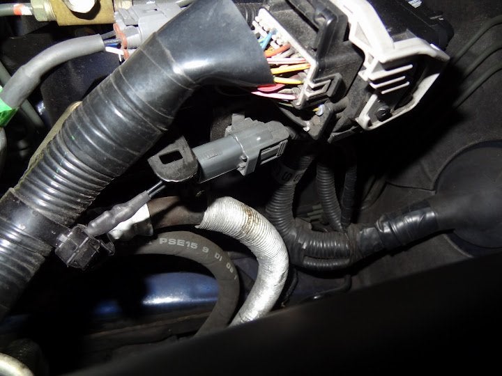

Resistor Mod for Uppipe Location
apexi replied to MDSubie4's topic in Fourth Generation Legacy (2005 - 2009)
Yeah looks like it could be below your main engine harness, least based off what I saw in the post below https://www.legacygt.com/topic/65194-the-unofficial-05-06-lgt-22k-5w-resistor-up-pipe-install-cel-fix/?do=findComment&comment=1694712 -
