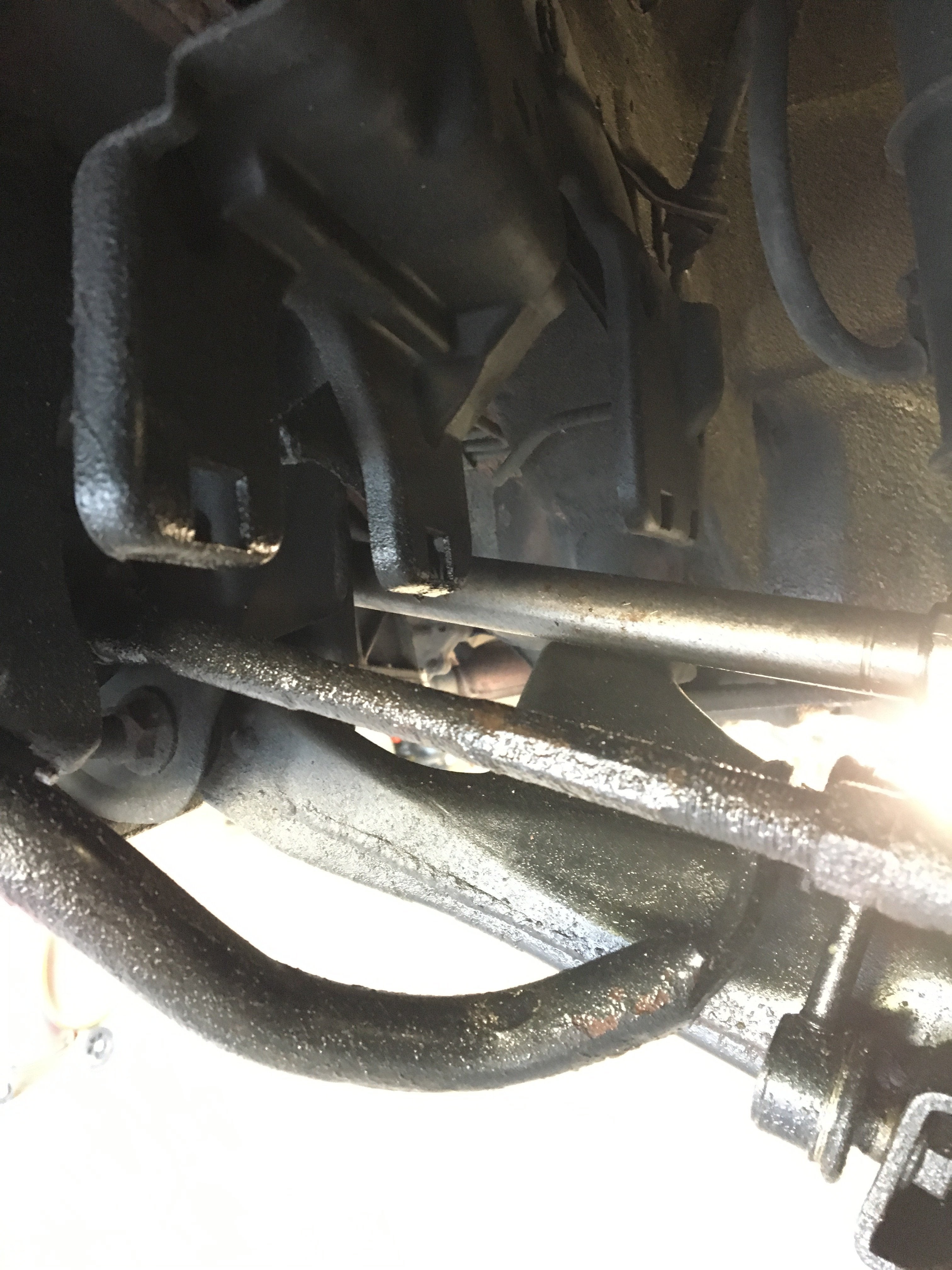

mygtlegacy Posted May 10, 2018 Posted May 10, 2018 Bump! I bought a used 2005 Subaru Legacy 2.5GT less than a month ago from Raleigh, NC Subaru pre-owned center and it has 136k miles on it. When I'm going trough carfax it looks Timing Belt has been changed around 108k Miles and the sales guy mentioned that it is been changed while on their possession. Now it looks like I'm having a same leak mentioned above, and it looks like its coming all the way down to my tie rod assembly. We have lift here and here's what we saw(Image attached). I'm starting to love the car and this is my first ever subaru and planning not to abuse it and will take care of it for another 150k Miles . I used to own a Toyota and Mostly Hondas. I wanna have that peace of mind when driving.
relative4 Posted May 10, 2018 Posted May 10, 2018 When chasing an oil leak, it doesn't matter how far down it goes. It matters how far up it goes. Follow the leak up to its origin.
mygtlegacy Posted May 10, 2018 Posted May 10, 2018 When chasing an oil leak, it doesn't matter how far down it goes. It matters how far up it goes. Follow the leak up to its origin. Thank you! I'll try my best to clean every places I could then locate where it coming from. If I can't find it I guess I'll just have to bring it to nearest dealership. Was kinda hoping that someone had a same experience and can tell me how they'd fix it.

relative4 Posted May 11, 2018 Posted May 11, 2018 If the oil keeps leaking and ends up on the headers/up pipe it will take cars of itself eventually. Otherwise, I was being sarcastic.Ah yes, velly good point. At the risk of being pedantic, looks like he's dripping forward of the manifold. OP, any smoke?
