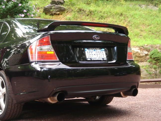

j255c Posted August 1, 2006 Share Posted August 1, 2006 Hey im curious how you guys were able to make the right can not sag down so much if u just have the axleback? I think they are too heavy for the exhaust hangers, but even my left one, which does not sag down sometimes rattles against the muffler plastic trim. Any ideas? 06 TB EVO IX SE stock turbo monster subaru hater Link to comment Share on other sites More sharing options...
BoxerGT2.5 Posted August 1, 2006 Share Posted August 1, 2006 It is Perrin, so the list could be endless. Pics would help. OBAMA......One Big Ass Mistake America! Link to comment Share on other sites More sharing options...
j255c Posted August 1, 2006 Author Share Posted August 1, 2006 bam shazaam http://i67.photobucket.com/albums/h300/c0lbyj/DSC01254.jpg 06 TB EVO IX SE stock turbo monster subaru hater Link to comment Share on other sites More sharing options...
TSiWRX Posted August 2, 2006 Share Posted August 2, 2006 Some have used the "C/worm-drive clamp around the rubber hanger" trick. <-- I love Winky, my "periwinkle" (ABP) LGT! - Allen / Usual Suspect "DumboRAT" / One of the Three Stooges '16 Outback, '16 WRX, 7th Subaru Family Link to comment Share on other sites More sharing options...

Brack Posted August 3, 2006 Share Posted August 3, 2006 Try 1 large Kartboy hanger for each muffler. That worked for me when I test fit a set. Puts them down away from the bumper cutout. Mike Link to comment Share on other sites More sharing options...

j255c Posted August 11, 2006 Author Share Posted August 11, 2006 eh it kinda worked... looks a little better right one still sags down low like the dominant .... 06 TB EVO IX SE stock turbo monster subaru hater Link to comment Share on other sites More sharing options...
TSiWRX Posted August 15, 2006 Share Posted August 15, 2006 Hum....looking on the Autospeed turboback thread, it seems that brother Tommyh is now going to try to "persuade" his system to hang a bit more in-balance by physically bending the hangers on-vehicle. Maybe this is another route? <-- I love Winky, my "periwinkle" (ABP) LGT! - Allen / Usual Suspect "DumboRAT" / One of the Three Stooges '16 Outback, '16 WRX, 7th Subaru Family Link to comment Share on other sites More sharing options...
zildjiank Posted August 15, 2006 Share Posted August 15, 2006 ^ I also might pursue the same thing w/ my Autospeed... But she is only .5 an inch off center on the right side...and well tucked in if I might add... Link to comment Share on other sites More sharing options...
