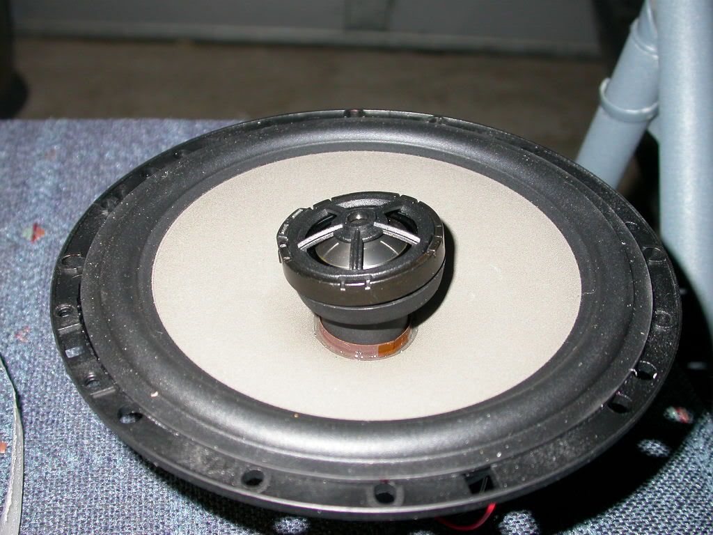

bnorton Posted March 27, 2006 Share Posted March 27, 2006 Update: April 18, 2006 Quarts installed in rear (practicing). (pics soon) Received the CleanSweep from SubieGT05 (good to deal with). Got a StealthBox in the works. Found a Montreal based JL Audio retailer today. It was not as easy as it sounds. http://mobile.jlaudio.com/dealerfind.php Dealer find pages do not work for Canada, not even Quebec. In the Contact Us page there is a reference to a distibutor, GemSen that handles Playboy, Hustler, Guiness and JL Audio brands. Got some $CAN prices for JL Audio amps. I would post the prices but it seems that this is not appropriate. PM me? Originally I was hoping to get one e6450. Dealer told me that 2 x 25 watts for the rears would not be enough. Leaning towards 300/4 for fronts / rears (4 x 75 watts) and 500/1 for sub. Considered the 300/2 for the sub but no sub remote / gain control. Found out I also need the following: 4 AWG power kit. Distribution Block. 2 fuses. Ground kit. RCA's. Speaker Wire. Total: $CAN 2250 + tax Installation $CAN 450 + tax (don't ask me what our sales tax is, it will only depress me) Converted to $US approx $599. Update: April 7, 2006: Just received some MB Quarts from PatagonianGT. Got a CleanSweep on the way from SubieGT05. Looking for a JL e6450 or similar. (Preferably from a Canadian source.) .......original post below........ I want to upgrade the audio system in my LGT Ltd. 5mt wagon. I'm a legacy, forums and car audio noob. I've been through the "interior forum" and paid close attention to the FAQ sticky and the "speakers" thread: http://www.legacygt.com/forums/showthread.php?t=11465 Still, I thought it might be good to share my research for other noob's and get some feedback from those who may have already looked at similar things. I've been to three local boutiques and here is what they've recommended (all in $CAN). 1. Rockford Fosgate 6.5" and tweeters up front (Punch line), P3001 amp, 8" sub installed in passenger side cubby. $1000 2. Infinity Kappa components with crossover for $350 + $90 installed. JL sub W1V2 in a box for $260 with a Clarion amp (AP 250) for $150 +$140 installed. Total: $1000. (approx) 3. MB Quart reference line components up front ($750) + similar coax speakers for rear ($300). + Alpine V-Power MRP-450 ($459). And for the sub an Alpine MRP-M450 with a 10" JL sub in a box. Add dynamat ($300) + wiring ($200) + labour 12 hours @ $55/hr ($660) and the package comes to $3528 or $3000 after some negotiation. Additionally: You will note that there is no Cleansweep in the 3rd quote. This seems negiligent according to the forums. I will be purchasing a StealthBox. (I have the wagon for a reason -clubs, boards, skis, lumber etc, etc, etc,) My thinking at the moment is: Add the Infinity Kappa components (and some coax's in the rear) and running them off the stock unit. Upgrade with CleanSweep and an amp in the future if that is still not satisfactory. Add the StealthBox with an amp (not sure what kind...). Total cost: <$2000 without CleanSweep and Amp for front and rear. Thanks in advance for your feedback. Cheap (CANADIAN) sources for components, a good installer in Montreal etc. every(all(at(forever)once)together)thing Link to comment Share on other sites More sharing options...
Chief_Wiggum Posted March 27, 2006 Share Posted March 27, 2006 Take a read through all of msmith's posts here in the Interior forum. There's lots of important info there. Feel free to go with the component speakers if you're set on them, but I believe the coax's up front will sound more coherent. Because of the spacing between the mid range and tweeter, you get some interesting sound artifacts with components. Careful listening with even the stock setup will bring this to light. I have coax's in my car and I'm very happy with the performance. No more strange detached high's either. The most important thing you can do is spend lots of time listening to your possible options. Listen to the different amps with the same speakers, different speakers with the same amp, etc. I've noticed a big difference in sound quality with my Cleansweep. If you're not adding an aftermarket head unit, I think it should be on your buy list. You're just not going to get loud clean sound out of the stock unit. I was skeptical that it would make that much of a difference, but after using it I'm a believer. If you're on a semi-budget, I would suggest: - CS - good set of coax's for the front (skip the rear, or upgrade later) - good 4, 5, or 6 channel amp - stealthbox - some dampening material for the front doors If you go with a >4 channel amp, you can add the rear coax's later and still have them amplified. Good luck and tell us what you decide! Link to comment Share on other sites More sharing options...
bnorton Posted March 27, 2006 Author Share Posted March 27, 2006 Thanks for your suggestions. I was under the impression that the CleanSweep was only beneficial if I was going to be installing a new amp. My bad. I have read a little on coax vs. components. There seems to be some debate on which is better. My thinking was that I would start with the components because they seemed to be cleaner / easier to install into the stock space. As for listening... it seems almost impossible and therefore almost useless. Only one of the local shops has a room approaching the size (small) and surfaces (leather and glass) of a car. And they don't have the speakers in a similar position (they are all at ear height and in proper boxes). As for dampening, I plan to follow the suggestions from Sands' excellent Sound Deadening sticky: http://www.legacygt.com/forums/showthread.php?t=7036 Finally, although I didn't state it in my first post, my goal is SQ (sound quality for other beginners like me). My preferred music is jazz and acid jazz. Roy Hargrove, Soul Live, St.Germain, Zero 7 and Cinematic Orchestra are in high rotation. There is always a spot for Keith Jarret's Koln concert. every(all(at(forever)once)together)thing Link to comment Share on other sites More sharing options...

fweasel Posted March 27, 2006 Share Posted March 27, 2006 As already metoined, forget the components and go coaxial. Coaxial does not necessarily mean a step down in performance (although many are more economical), it just means the tweeter is mounted on the same axis as the mid bass driver. I have Quart seperates in my other car, they sound great. The Legacy's cabin definately benefites from coaxial speakers up front. I have a pair of Morel coaxials and the SQ is excellent. I didn't bother replacing the factory speakers in the rear doors as I am more of a two channel purist. The only time they are used is in 5.1 surround playback. ignore him, he'll go away. Link to comment Share on other sites More sharing options...
