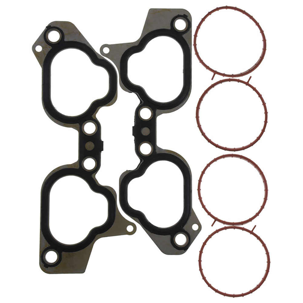

Becks1818 Posted November 1, 2017 Author Share Posted November 1, 2017 Annnnnnnd more parts are in Not sure why Subaru gave me 3 intake manifold gaskets though... Sent from my SM-G930W8 using Tapatalk Link to comment Share on other sites More sharing options...
A_A_ron Posted November 1, 2017 Share Posted November 1, 2017 Clearly you are meant to stack the manifolds for triple protection. That's how it works. I would know. My father was an EJ. As for the rest of this build, Dis gon b gud Build Thread Link to comment Share on other sites More sharing options...
Becks1818 Posted November 1, 2017 Author Share Posted November 1, 2017 Clearly you are meant to stack the manifolds for triple protection. That's how it works. I would know. My father was an EJ. As for the rest of this build, Dis gon b gud Ahhhhh now it makes sense!!!! Haha. So in that case, I'm short a gasket!! Thanks buddy! It's been fun so far and all I'm doing is collecting parts! She goes in Nov 6. The wait is killing me. Sent from my SM-G930W8 using Tapatalk Link to comment Share on other sites More sharing options...
FLlegacy Posted November 2, 2017 Share Posted November 2, 2017 Ahhhhh now it makes sense!!!! Haha. So in that case, I'm short a gasket!! Thanks buddy! It's been fun so far and all I'm doing is collecting parts! She goes in Nov 6. The wait is killing me. Sent from my SM-G930W8 using Tapatalk Since I would assume you are using the TGVs you actually do have an extra but the intake gaskets are O-ring type gaskets since the intake is plastic. https://www.buyautoparts.com/data/all_images/MS19516-MH.jpg Link to comment Share on other sites More sharing options...
Becks1818 Posted November 2, 2017 Author Share Posted November 2, 2017 Since I would assume you are using the TGVs you actually do have an extra but the intake gaskets are O-ring type gaskets since the intake is plastic. https://www.buyautoparts.com/data/all_images/MS19516-MH.jpgThanks! I have those o rings as well. Sent from my SM-G930W8 using Tapatalk Link to comment Share on other sites More sharing options...
